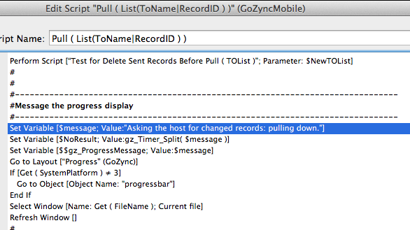

You can add whatever else you'd like to the log. Here's how.
In any script, set a variable $NoResult to the custom function "gz_Timer_Split" and pass into the function whatever you'd like to see in the log. For example, this...
gz_Timer_Split( "Connecting to server..." )
...adds the phrase "Connecting to server..." to the log and gives it a split time. You can do this in the scripts of both GoZyncMobile and GoZyncHosted.
Not sure which scripts to insert steps into? The log can help there as well: run a sync and then find a phrase in the log you're interested in, like "Looking for records to delete". Then search the scripts of GoZyncMobile / Hosted for that phrase and you'll find exactly where that happens in our scripts. (Turns out "Looking for records..." happens in the script "Delete Records Not In The IDs List (IDs)" in GoZyncMobile.)
If you run a sync with some breakpoints in that script you can use the data viewer to see what other variables you have access to at that point for possible inclusion in your new log message.
Needless to say, this is one of my favorite parts of GoZync: I hope you have fun modding it.

"I hope you have fun modding it" :shock: Maybe if I understood it, maybe ;)
I found the step shown below in the "Zync It - Public API - ( TOName ) { Action ; RecordID }" script:
Set Variable [ $NoResult; Value:gz_Timer_Split( "Running default action for " & $gz_TOName & " : " & $gz_Action ) ]
End If
This looks like it would list the TO and the Action but I'm not sure if my Zync method is using this script or not. How would I check?
Brian.

I'm not sure I'm following Brian: you don't edit the script "Zync It - Public API", you simply call that script with the parameters described in the head of that script.
Maybe you can let me know what you're trying to accomplish.

Hey Brian! I thought we were including the TO name in all these messages, but looks like we weren't including the name if you were just pulling. Fortunately this is easy to fix. Edit the script "Pull...." in GoZyncMobile and find the line shown in blue below.
Change that message to include the TO name like this:
"Asking the host for changed records: " & $TOName & " - pulling down."
Thanks for catching that.

Hi John,
Thanks for the script amendment, that seems to work great now.
