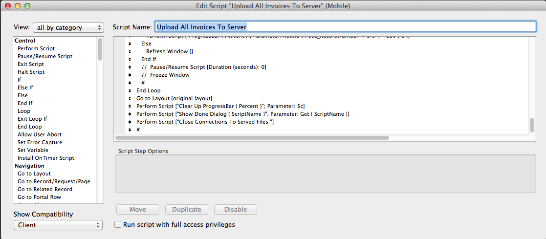

We're calling the Go to Layout [original layout] script step there at the end of our "Upload All Invoices To Server" script:
and that should work on Pro as well as Go. Is that what you have?
