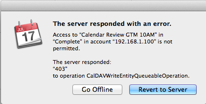

iCal does respect FileMaker's Account Names / Privileges. With the privilege set below, if you try an change an event, you should get this:
Screen Shot 2012-01-13 at 9.37.37 AM.png (37.25 KiB) Viewed 10024 times
If you're using the Separation Model, where the actual data lives in a different file than you published from, than those privileges need to flow all the way through. That's a common issue we run into.

Sorry for taking a while to reply, but I wanted to make sure that I was correct in what we were seeing.
With the privilege set outlined in my original post, users are able to move and delete records in iCal, and that will flow through to the FileMaker database. Aslo, we are not using the separation model.
Prior to the most recent update, users would see a message similar to the one shown above. However, since the update for iOS 5, that has not been the case.
I'm open to suggestion...
