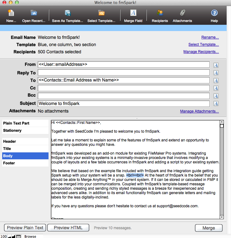

So there's two areas in FMSpark for text, the Plain Text option and the the HTML Regions. For the Plain Text option, ¶ should work fine, but for the HTML part use <br/>. See below:

In case anyone is following this thread, Jason very helpfully provided the answer off-line.
Use the FM Substitute function to replace the unsupported '¶' character with the appropriate HTML code for a line break.
<<Substitute ( List (ChildTable::ConcatenatedField) ; ¶ ; "<br/>" )>>
