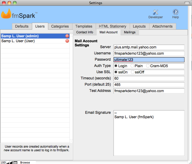

Typically we'll see an SMTP error if mail.it can detect an issue. Make sure that you've got the settings tied to the account you're using on the Users tab in set up. A common problem we run into is folks update the default tab, which is only for new accounts, but not the correct user settings like the last image I posted.

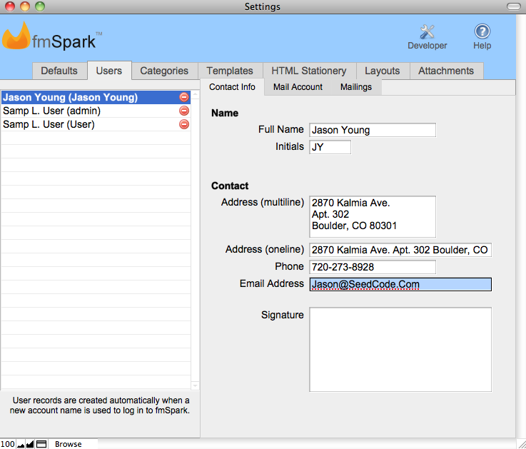

So either Cox doesn't like the "From" address you're specifying or there's no "From" being specified. If you're using FMSpark's "Samp L. User" then it should be "fmsparkdemo123@yahoo.com" but if you're using a new account you may want to make sure the e-mail address is filled in.
Screen shot 2011-08-18 at 3.03.52 PM.png (86.8 KiB) Viewed 141201 times
