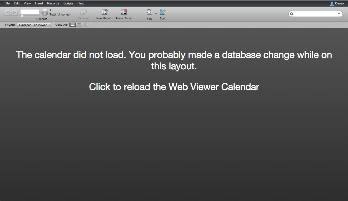

Trying to demo the WebDirect calendar for a client. The webviewer layout in FMPro Adv looks great. WebDirect does NOT work. Reloading does nothing.
How do I get this to work?
- Screen Shot 2014-08-25 at 3.09.26 PM.png (82.97 KiB) Viewed 37393 times

Try closing the file on the server (unhosting it), quitting your browser, then bringing everything back up again. Let me know if that does the trick.

List view is fine. WebViewer Calendar layout still gives same error.

Is this the currently shipping Pro Calendar with the Web Direct layouts you're working with? Or the preview/demo of the not-yet-released Pro Cal with the Javascript/Web viewer?

AH yes, now I see MY error! So sorry, it is the not-yet-released version. My bad! Apologizes. When will it be released?

We don't actually have a release date yet. FYI the web viewer object will not be compatible with Web Direct, however we are planning to integrate an option to work with the Javascript calendar view directly in a browser. Stay tuned.
