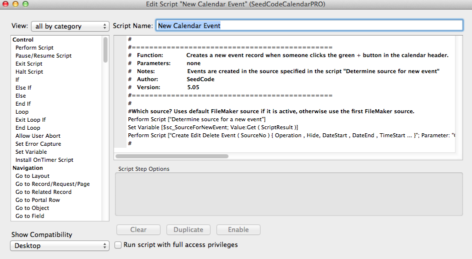

Don Penhailegon wrote:I think I would prefer to create a ToDo item from the focus of the Calendar than from the ToDo List
Perhaps I can duplicate the new ToDo button on the Calendar layout or would that not recognize the source number?
Right, if you only have the To-Do source selected than it will create the event for that source, but if you have both selected than it goes to the one you define as the default in the start-up settings script. By default, that's Source No 1. The New Calendar Event script runs a sub routine at the beginning to determine which source to use, so it would be pretty easy to use a parameter to bypass that and just set the Source to what you want.
New Event.png (111.3 KiB) Viewed 23464 times
Let me know if that helps!
